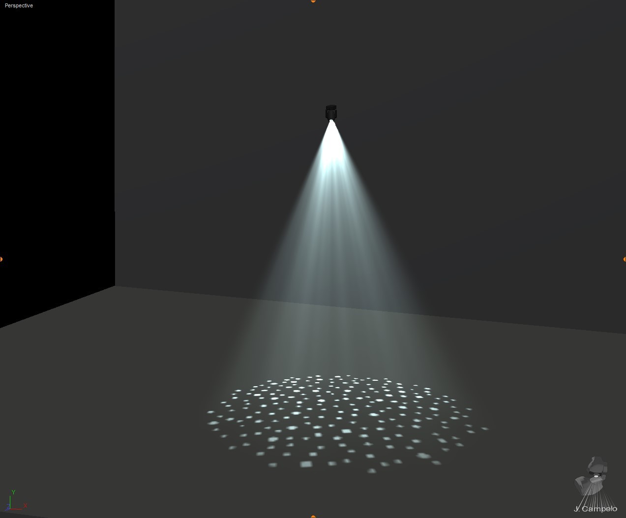

MAC Axion with a breakup gobo. The beam looks like more near to a wash fixture that a beam with a fine breakup gobo

For the Axiom break up, this is due to the fat that several small beams overlay each other, bt let see if they can improve the definition.

Quality is allways setting to “Best” in my MSD.
In the Axion case if i change the gobo with another with less beams and no so smalls,things does not goes much better.

Note that the beam problems starts when it goes facing the camera or near to facing the camera.
Lighthouse is looking into it.
