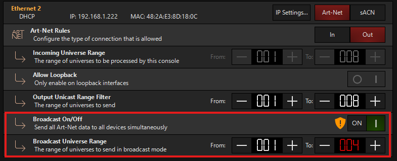

You could potentially workaround this by enabling Art-Net Broadcast in ONYX. This means ONYX will output ArtDMX, even if no devices are responding. If this does resolve the issue, we ideally need to understand why the DMXKing eDMX2-Max stops responding to ONYX, or ONYX stops hearing from the DMXKing eDMX2-Max

So that ONYX doesn’t flood the network, you can configure ONYX to only broadcast a small range of universes…
