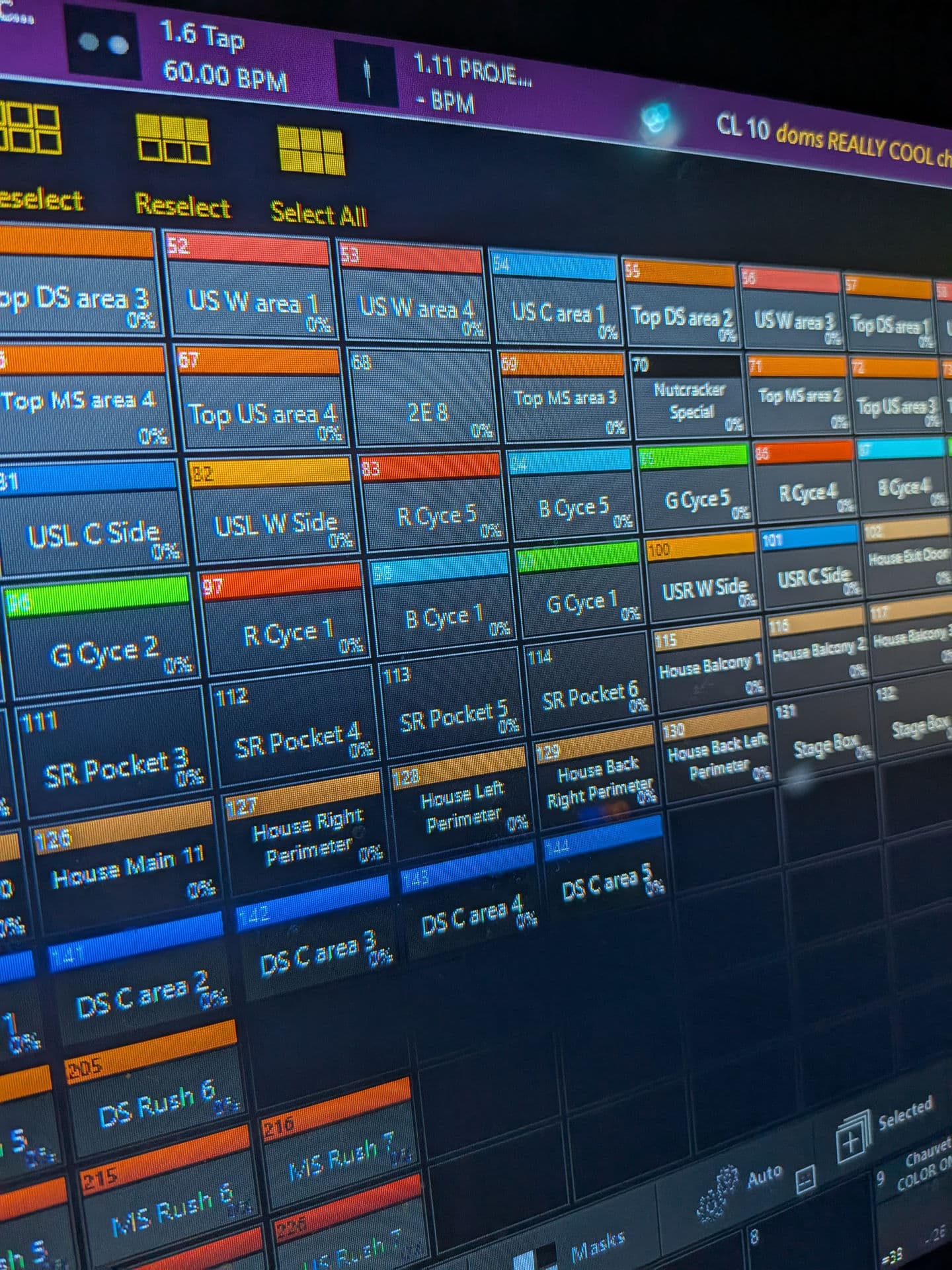

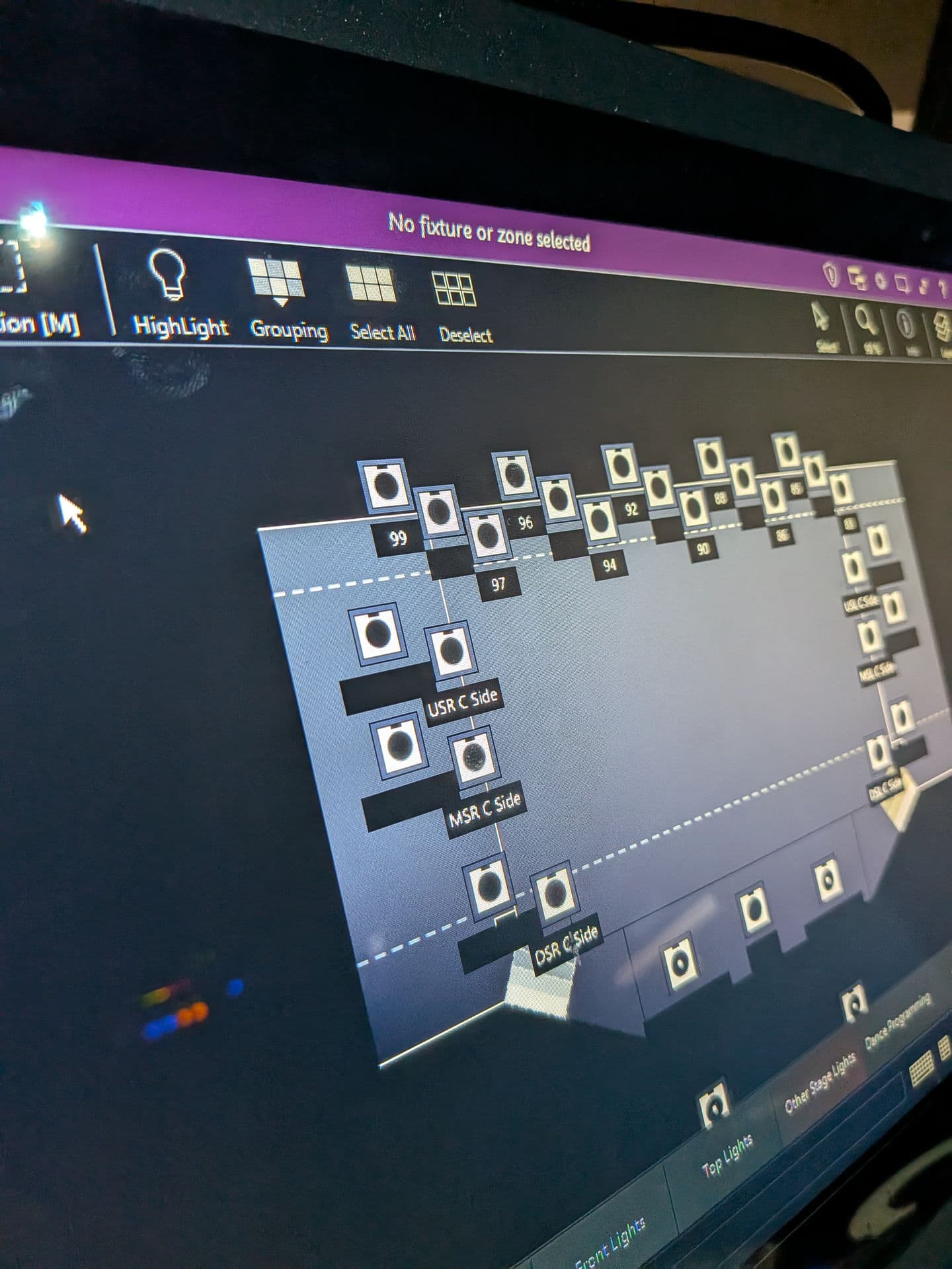

Hello, we just updated our M6 upgrade kit to ONYX 4.32.1302.0. Upon loading our show and workspace, some parts of our 2D plan are broken. For example, some fixtures have a “Fixture Color” set, but that is not displaying on the 2D plan, instead it is all black. Furthermore, some fixtures just show their ID on the plan instead of their name. This was not an issue before updating.
Attached are some pictures where you can see a fixture has a color, but it is not showing in the 2D plan.

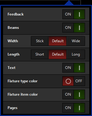

In the meantime, I would recommend clicking the settings cog in the 2D Plan, and switching off Fixture Type Color. This will then allow the fixture text to be displayed correctly…
