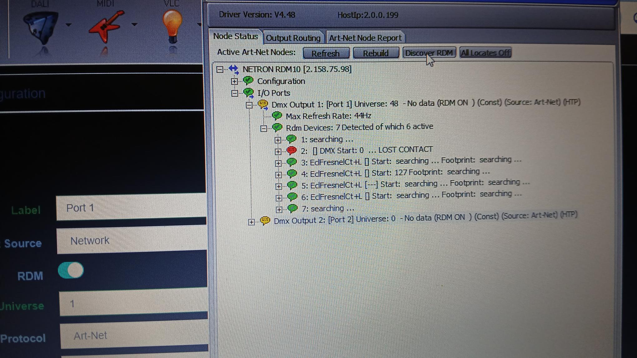

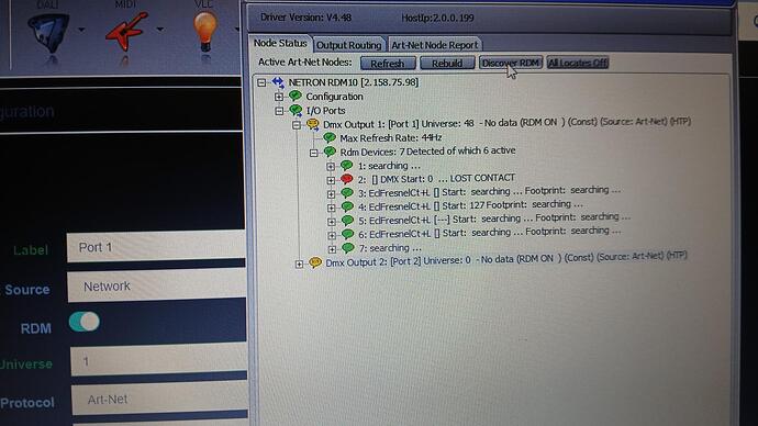

I tried it again without the grandMA3 console and I see some strange behaviour. I used only a Laptop with DMX Workshop Version 7.50, a Netgear Switch and the RDM10.
One LED Fresnel Fixtures works fine, I can Identify the fixture and the RDM10 stops the white RDM blinking after a while. Two fixtures also work. If there are more than two fixtures connected via DMX, the RDM detection becomes unstable.
When I connect all 13 fixtures, the RDM10 flashes very long in white and detects not all fixtures in the Webinterface. DMX Workshop detects (mostly, but not always) 13 fixture, but doesn’t display the data for most of of them. About every 10th time I tried, I was able to reproduce the universe change after clicking “Discover RDM”. See attached photo showing the difference between software OSD and DMX Workshop.
Unfortunately, I haven’t had a chance to try RDM with these fixtures directly via DMX (so without the Art-Net layer) yet. But it seems that the devices we use aren’t exactly simple :slight_smile:
