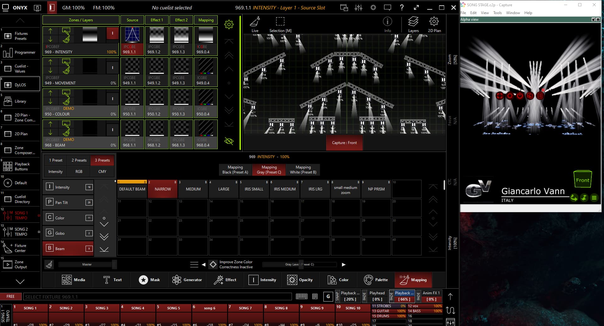

Hi to all Using Dylos 3 preset mode:
I have noticed that if I use dylos in 3 preset mode let’s say 3 different “positions” and set a smooth speed all works fine! but if you change one of these presets like I did in my case “preset 2”, and insert there a zoom preset ,what happens is that the pan tilit ones preset 1 and 3 loose the smoottheness of movement. Just to make an example they look like scanners going faster than the original speed ,even if nothing has been changed on the original speed!
The fixtures lost a pan tilt step from preset 2 , so wouldnt they need to travel from preset 1 to 3 and thats black to white so its a lot stronger change = faster movement or even jumps?
When editing with this feature ,please show us" active non active" or otherwise make this an automatic selection of all fixtures in the current edited cue! = )
