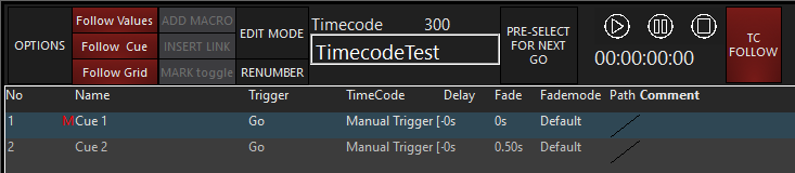

Is there a way to adjust the column width in the Active Cuelists window? I can’t see all of the information in the TimeCode column and don’t see any way to make it wider.
Currently, the columns and rows in the Selected Cue List window are fixed, and the widths cannot be adjusted.
In a future software update, this window is being migrated to a new architecture, which will then allow the columns and rows to be customised.
Good to know. Thank you.
Is there a workaround that would allow me to see the values set in the Manual Trigger settings that are currently covered up be the next (Delay) column?
The “TimeCode” column is wide enough to display the standard timecode format (HH:MM:SS:FF). If a timecode stamp has not been added, the field will display “Manual Trigger”.
It will actual display Manual Trigger[-] which isn’t fully displayed indeed and is a ‘helper’ to indicate that filling in a “-” as time value will reset the current TimecodeTime to Manual again.
