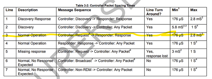

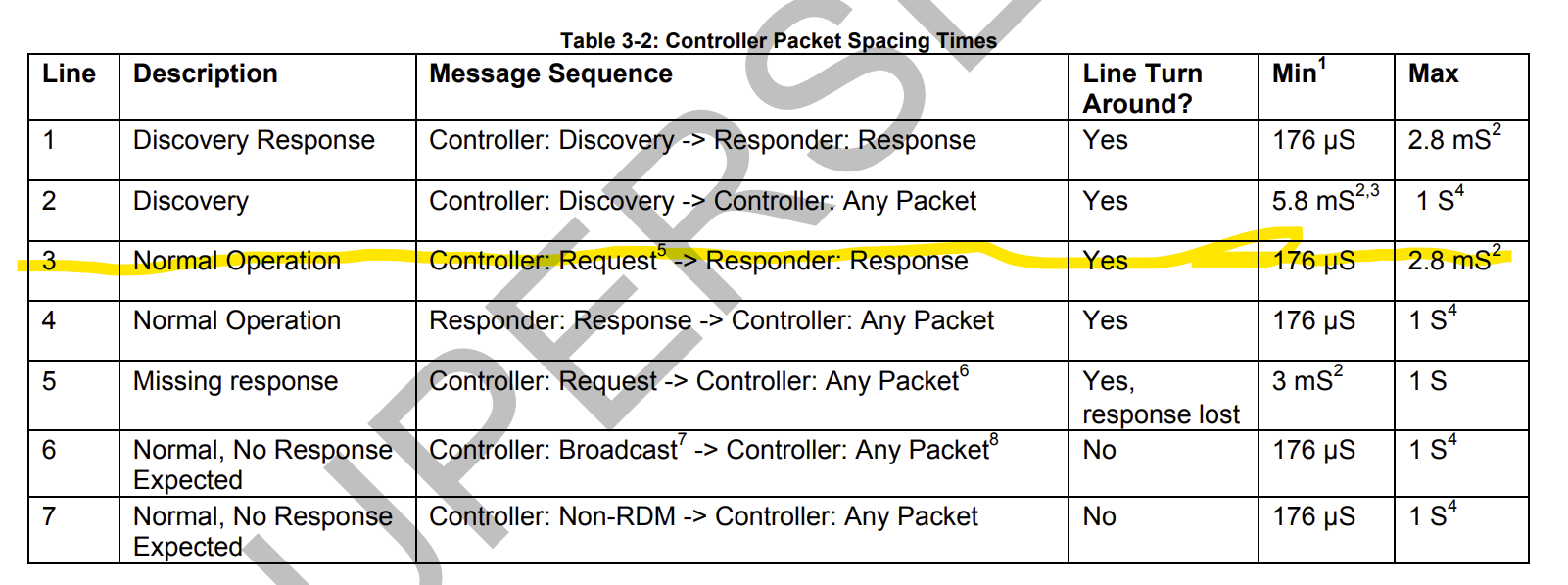

This is bag, because this Blocks DMX from being send to the Devices. And it makes no sence to wait so long for Responses.
As Spec it should timeout after 2.8mS
