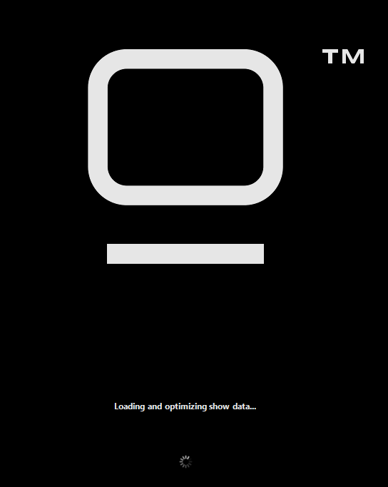

I am getting stuck here on the screen :
So I tried to uninstall ONYX 4.32, reinstall ONYX 4.10 : the file loads properly in 4.10
After this, I uninstalled 4.10, installed 4.32 again and now the files loads in 4.32, but it takes a while (more than 2 minutes to load) (note : sometimes it got stuck again and doesn’t even load)
When it loaded, it prompts me that some DYLOS upgrade is available so I should update my channels : I accept.
Then it prompts me that the show was upgraded and that I should save it for faster loading : I accept
After this, I close ONYX, and when I open it again and try to load the file, the never ending loading screen is back :frowning: (I tried to wait like 30 minutes, but nothing happened)

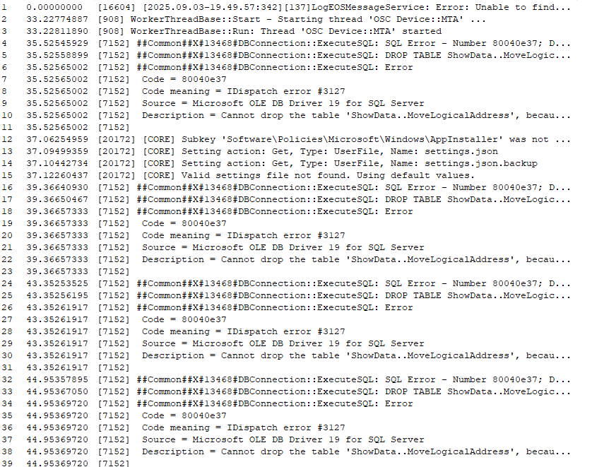

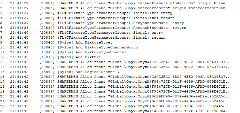

I tried to compare the loading process in WINDBG
Here is the file in 4.10 (everything is OK, takes like 20 sec to load, no error)
And here the log file in 4.32 (with the same file saved in 4.10)
Seems to be a database error or something like that, stuck in a endless loop

Hello, the problem is with the Algam MiniWash 710 fixture type. It has a split intensity/strobe channel, but in the past the intensity wasn’t modeled properly, so the fixture type allowed for a virtual intensity to be added. With the latest library update (so this would also occur in 4.10 if you update to the latest fixture type library), the modeling for that channel is corrected, but that makes the type no longer being eligible for virtual intensity (as it would cause a conflict). That update actually corrupts the binding between the 2 fixtures and their channels…
If you’re back at 4.10, before upgrading the software to 4.32 (or even updating the fixture type library), make sure you swap out both fixtures (536 and 537) for the same type with virtual intensity turned off (select the type for both fixtures in the patch grid and turn off the virtual intensity in the library browser popup; then execute the prepared commands).
