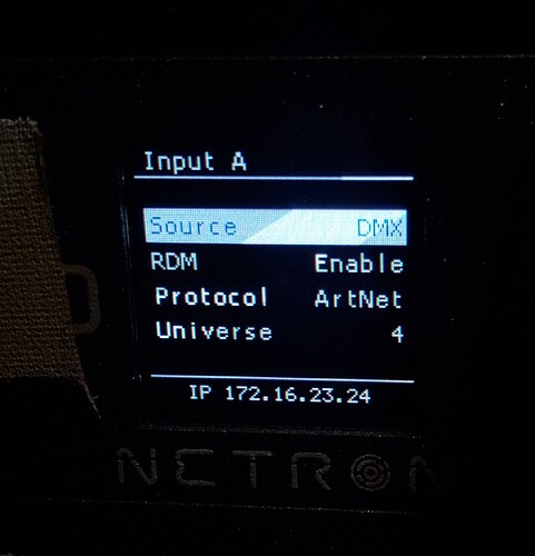

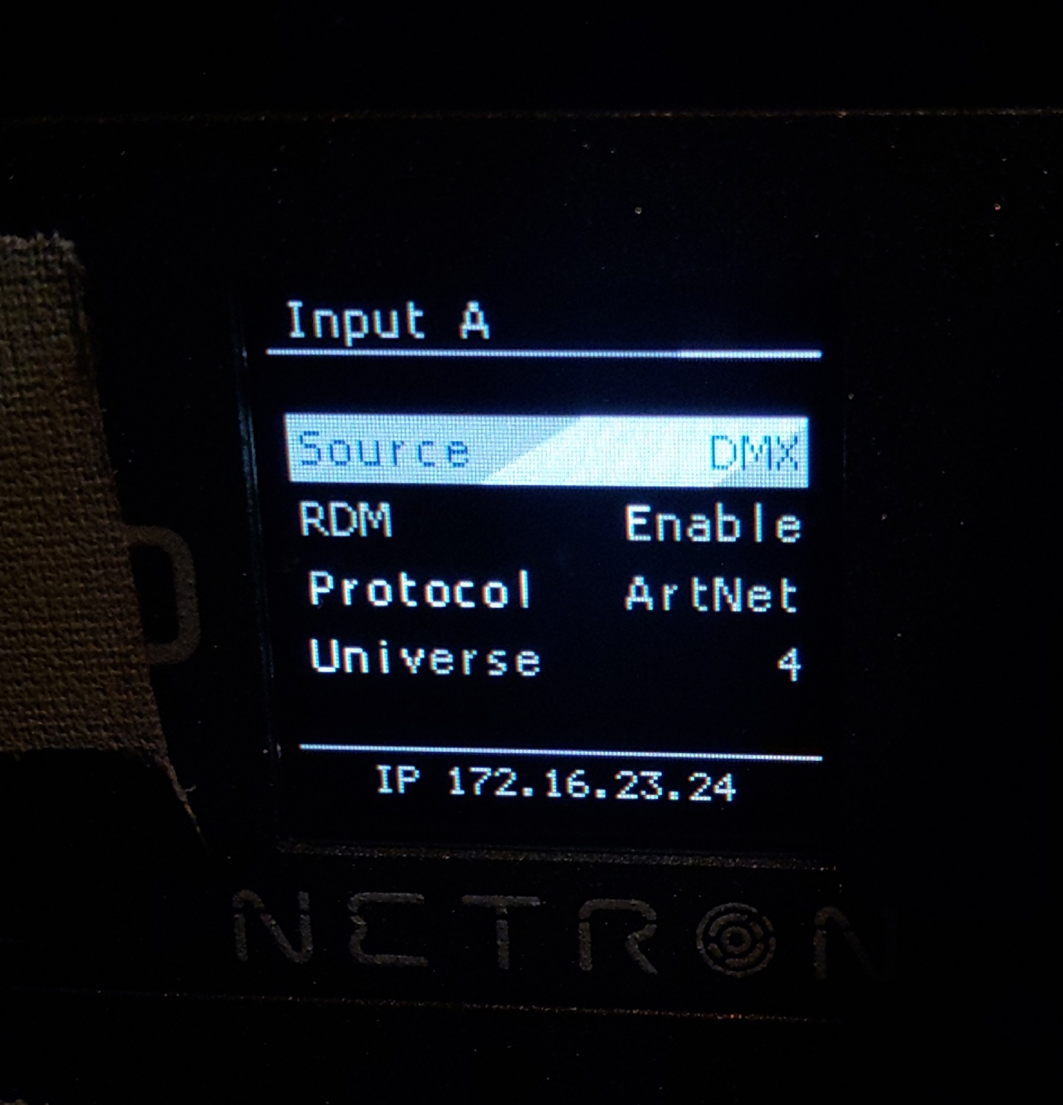

If it helps, I’m also seeing the same behavior with ArtNet. Even with my console and everything else in my system off, the RDM10s are still showing up as an ArtNet source on my lighting network. All RDM10s are in the Splitter A factory preset, and all inputs are set to DMX.
Attached is a photo of the Input configuration screen. You can that even though it’s set to DMX, it still has options to set the network protocol and universe number.
