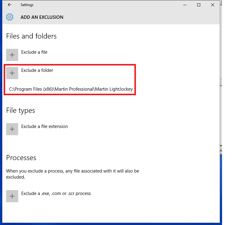

This issue is caused by your AV software (credit to Paul :-))
You need to exclude LJ from your un-trusted programs
Here is an example taken from my Windows Defender, under Windows 10
Hi Ofer, I am running windows 10 and Norton Anti virus which means defender is automatically switched off if it detects another anti virus programme so i am told
I am not a pro pc user meaning i dont know how to switch defender back on? is this what i need to do? I am sorry to sound confused but i dont understand how to do this…
This is not what I meant… I only used defender as an example to what needed…
Any AV will let you exclude files from being continuously scanned
As LJ file type is unique, it is unknown by the AV software, which in turn suspect the files are infected, so it scans few thousand files, each time Fixture Configuration is being accessed

I doubt however that this is affecting the performance
It’s not but LJ.exe, it’s about the entire LJ folder
In my case, the performance went from 4 min, to 4 5sec…
