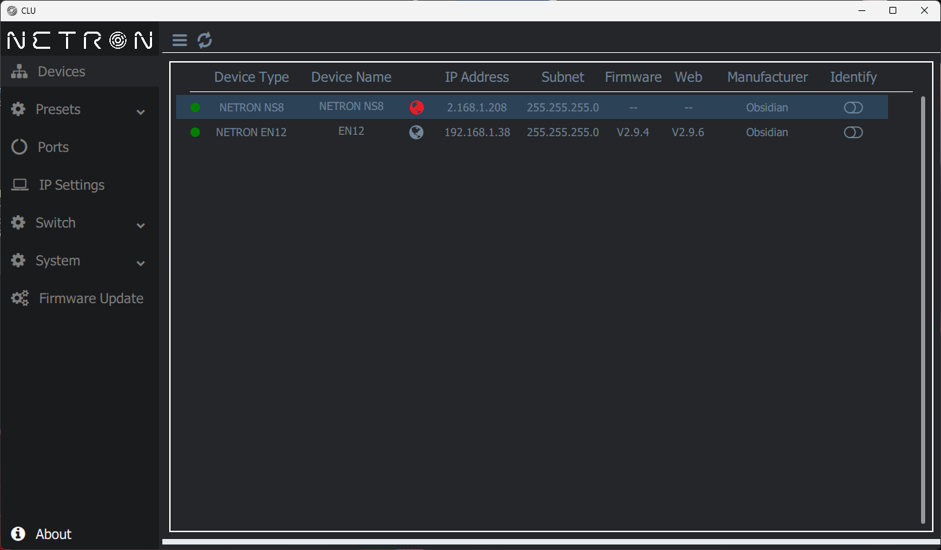

hello, clu can see our ns8, but the options are not working. so how can we change this? thx
Hi @deflost
If CLU has discovered your NS8, but the options down the left side of CLU are greyed out, this suggests your NS8 is on an IP address/subnet mask that cannot be reached by your PC…
If you change your NS8’s IP address/subnet mask using CLU, or change your PC’s IP address, the options will then become available, to link you to the relevant NS8 webpage…
