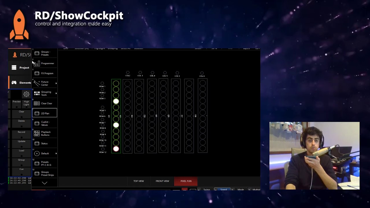

Here is a tutorial from show cockpit:
You can now Tap the fx speed! ![]()
