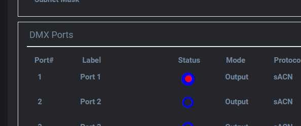

This was added to the EN12 and EN12i in Version 3. So far its only supported by the web interface, not CLU. It uses an Art-Net compliant label field per port.
Please use the updated version of CLU (v1.1.1) linked below.
Cheers mate. Where do get firmware version 3? Online its still 2.9.4.
