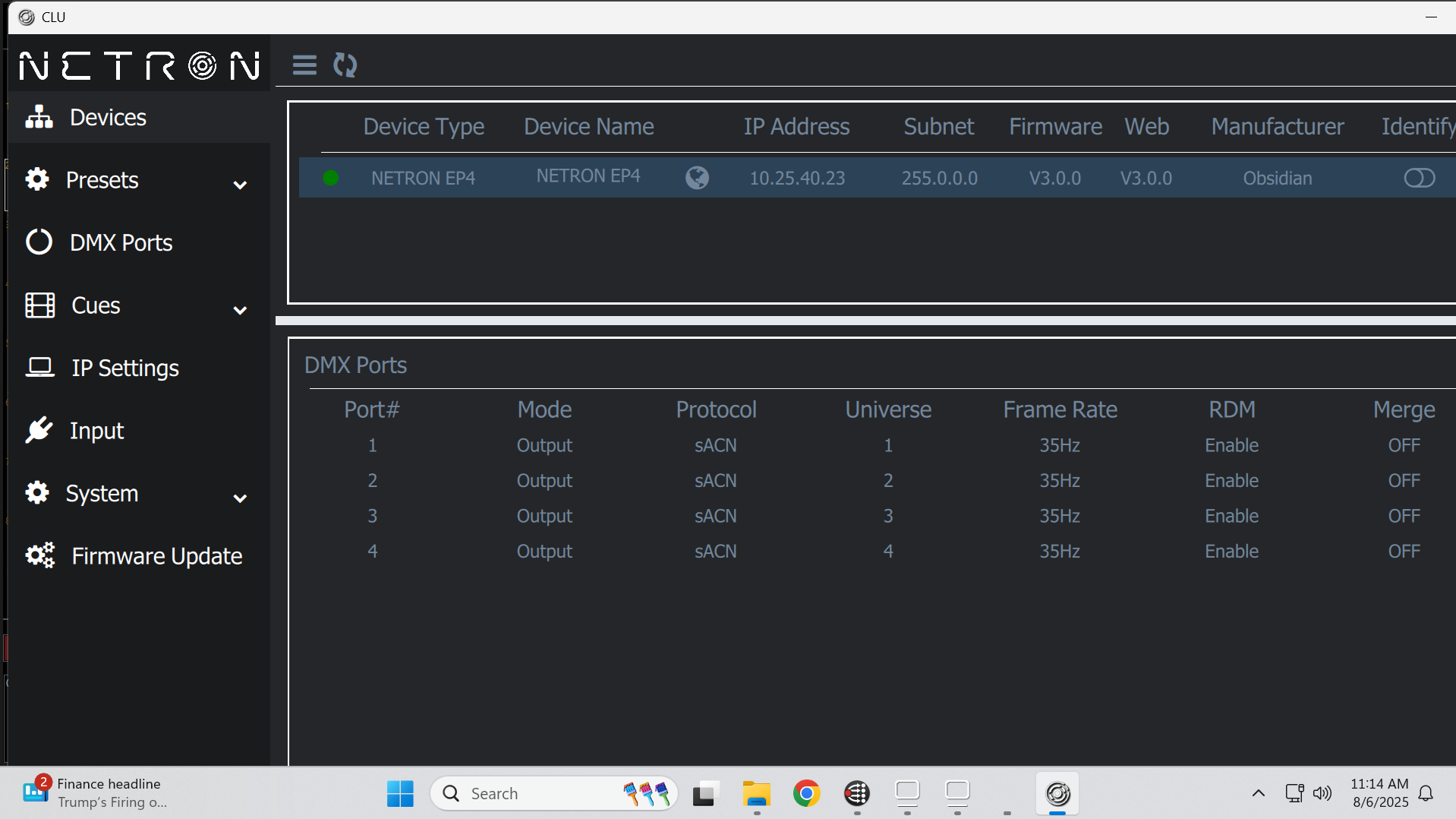

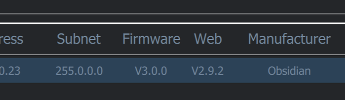

Both need to be V3.0
Still the same issue even with matching firmware.

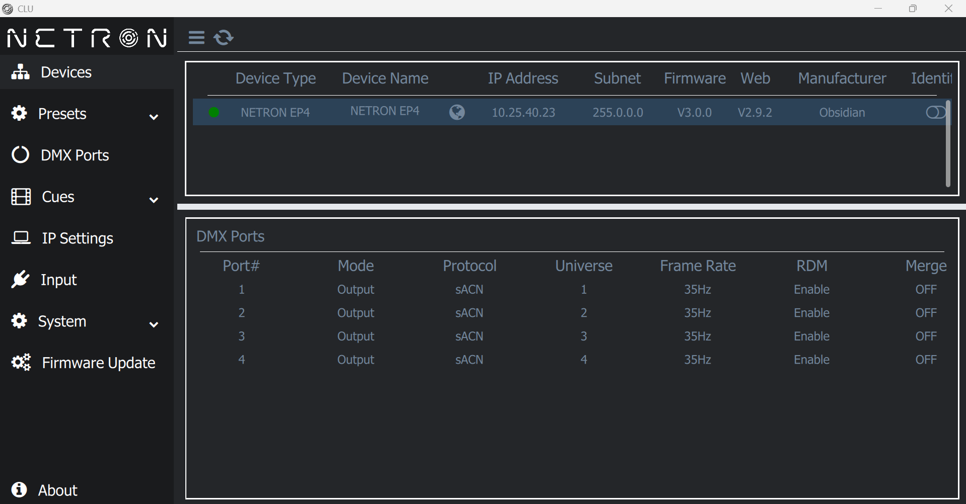

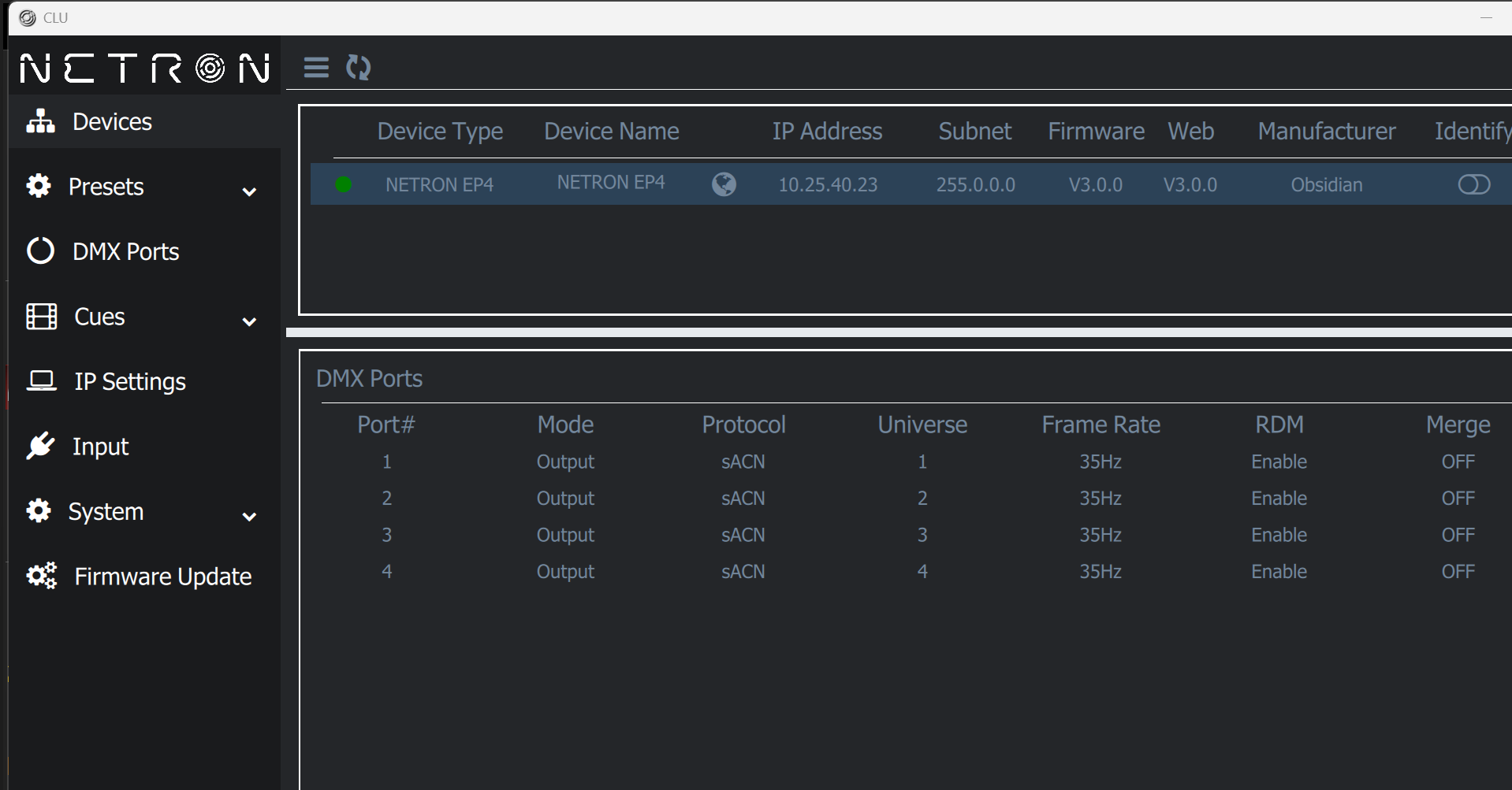

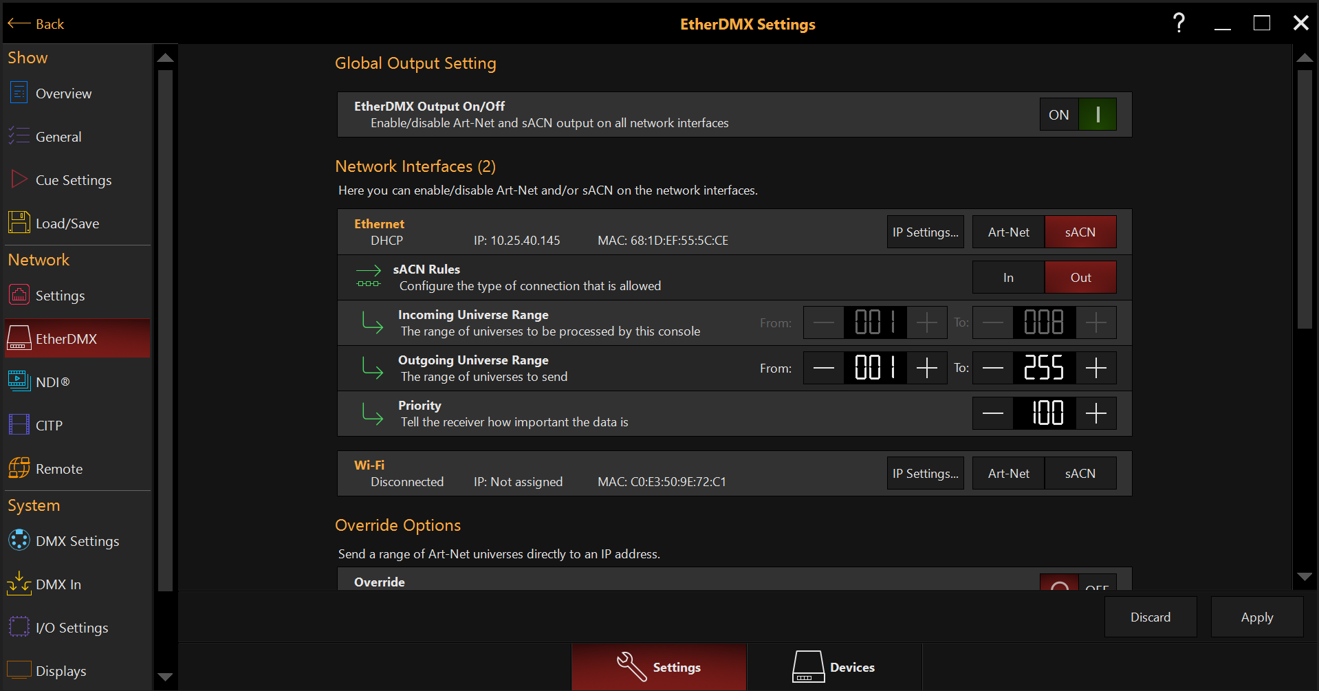

Thank you for the screenshots.

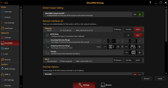

Please enable either sACN or Art-Net, depending which protocol you wish to use.
In your screenshot, EP4 is configured to receive sACN, so you can disable Art-Net output from ONYX.
Even with Art-Net disabled, ONYX will still perform Art-Net discovery, when sACN is enabled. ONYX won’t however output Art-Net DMX.

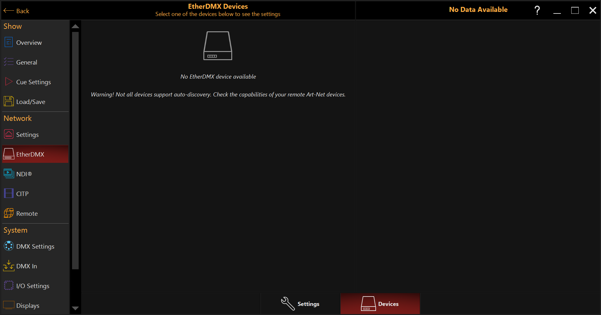

In Menu > EtherDMX > Devices, you should then see the EP4 detected. If it is not shown, this means ONYX cannot see it, and so is not unlocking 4 universes.

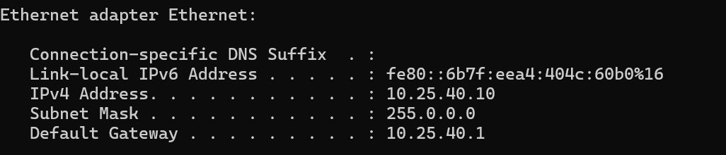

Please also make sure your PC’s Ethernet adapter also has a subnet mask of 255.0.0.0.
SACN is outputting. Nothing pops up in the device window.
IP settings are correct. It’s on an isolated network with only the NODE and PC on the system. CLU sees the node without problem on the same exact PC running ONYX.

Can you elaborate on Edwards statement? Does this mean the Art-Net Protcol communication option under Network / Settings / Interfaces (for the desired NIC Interface) should be enabled, but the Network / EtherDMX / Settings / Ethernet (Art-Net) In/Out options should be “disabled” (Greyed out)? Thus, allowing the Art-Net communication but not actually sending any Art-Net traffic onto the NIC?
Thanks,
Tim

Thank you for the confirmation. With this configuration, ONYX will be looking for Art-Net devices on the network, such as the EP4.
Please make sure that the subnet mask of your PC is also 255.0.0.0. CLU uses a discovery protocol called “LLRP”, which is able to see through invalid IP addresses and subnets. Art-Net discovery requires devices to be on the same IP scheme, with a matching subnet mask.
This is also a great suggestion - please try setting your PC to a static IP address and subnet mask for now.
To clarify, you do not need Art-Net enabled at all, to perform Art-Net discovery (polling). So long as either sACN or Art-Net is enabled on an interface, ONYX will perform Art-Net discovery on this interface. Art-Net DMX will only be sent if Art-Net is enabled, with “Rules” set to Output.

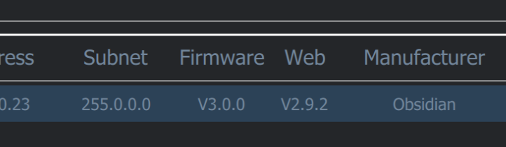

Going to try new firmware and see what happens.
Computer is set on a static.

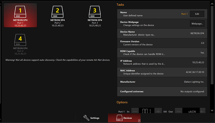

ONYX sees the node…
It still is not unlocking :tired_face: . I try to refresh to force find the license. No luck.
What’s the subnet of the EP4, Gateway setting.
show a screenshare of the Ethernet settings in Onyx.
