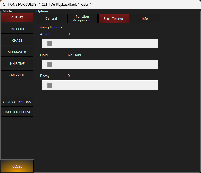

Apologies - I’m not quite sure what you mean. In a Cuelist’s Options, the Flash Timings tab allows you to configure a button so that the cue fades on, holds, and then fades off automatically…
