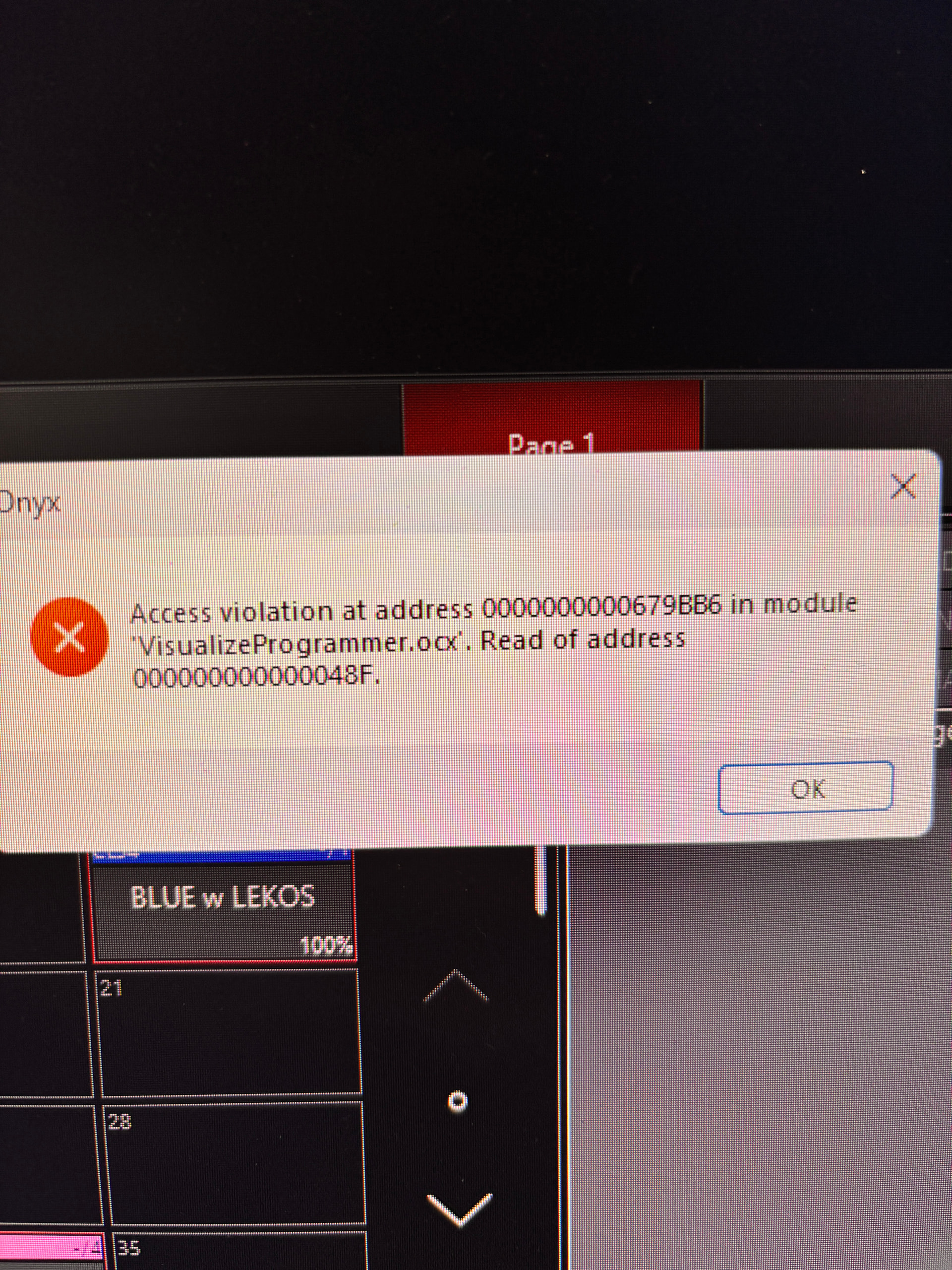

Over the last three days, when booting up my NX2, I get to the load screen, I load my show, the console takes longer than usual to load the show, then I get this window:
Hitting OK doesn’t do anything and when I hit X to close the window, I get a blue spinning circle of death. Then when I power cycle the board, I get a normal boot up and everything is fine. What’s going on here?
Is the time and date accurate? I’m wondering if the internal CMOS battery is failing. Longer boot times indicate that. I had that error once also, but can’t remember if I just did a reinstall of the OS. That said, 4.10 is an older OS. Is there a reason why you don’t want to update to the current (4.32.1311 OS)?
