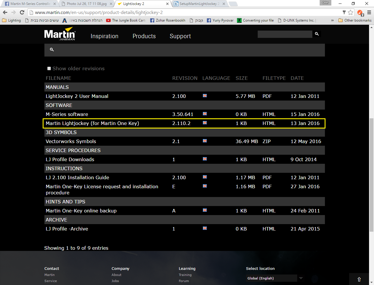

Hello Truth,
The download link is not under Downloads… It is under Tech Docs…
Yes, I know the new Martin web is a mess… It was endlessly discussed already, and I gave up on it. I just learned my way around it…
LJ V. 2.11 is there for download:
Regards,
Ofer

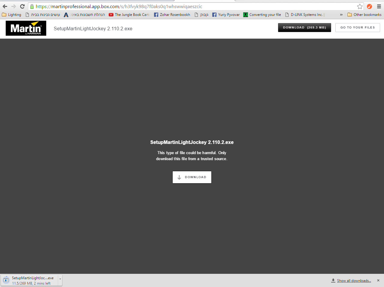

Hey Ofer,
Thank you. I missed it this time, though now remember seeing it. I hadn’t tried installing the Onekey version. It worked but this version also removed the “OV” (Offline Visualizer) and replaced it with the MSD demo. The only place I could find the non-Onekey version was in the link I previously posted but that one won’t install.
