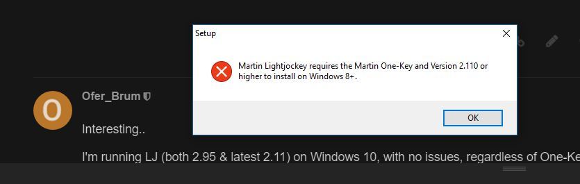

I can’t install Lightjockey because I upgraded my computers to Windows 10. None of the available downloads allow me to install, not even in compatibility mode. I don’t have a onekey. I purchased my Martin gear before the Onekey program. Some day I would like to get all that but there is no need to explain, except for your questions.

I’m running LJ (both 2.95 & latest 2.11) on Windows 10, with no issues, regardless of One-Key (One-Key does not affect installing or running LJ at, all, it only permits DMX output)…

truthcollins, you’re absolutely right about the installers. I noticed the same thing recently, as I also remember being able to install whatever I wanted on whichever computer I wanted (the only limitation was which drivers were available for each hardware). Somebody must have thought they could drum up a few more sales by being more restrictive…
Here’s a link to v2.95.1 (pre-One-Key hardware) that I’ve had for quite a while, and should let you install it anywhere. Let me know how that works out for you, as I have others as well (I have just about every version of LJ that ever existed). http://lb1.us/u/LJ_2_95_1_Med.zip
