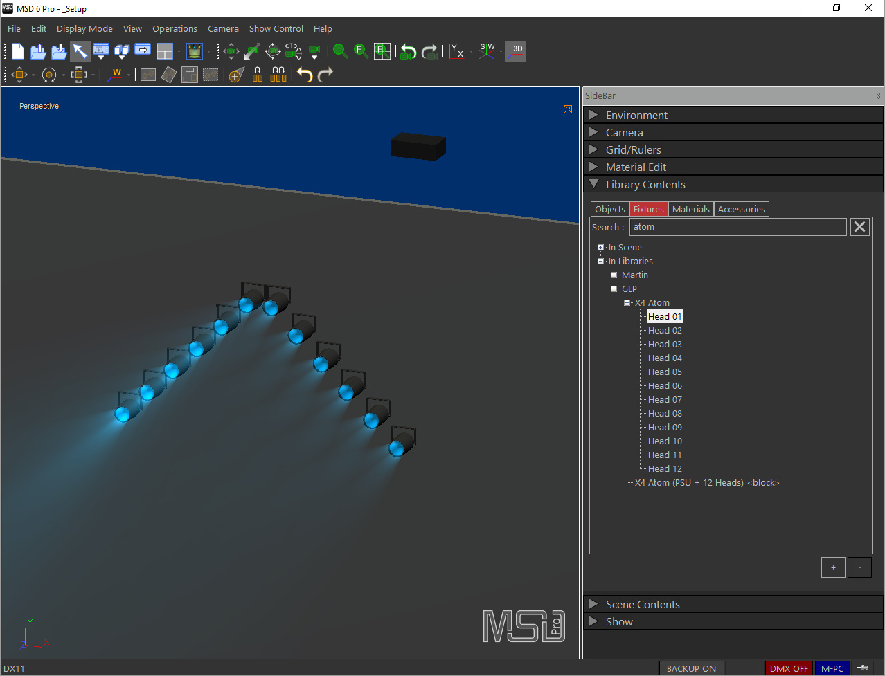

Regarding GLP Atoms: Does this mean I would have to patch the Fixture Block, as well as the individual heads? (can’t seem to get them to work when I only patch the head themselves, and I don’t see the power supply)

Hello Jamey,
The GLP Atom are implemented as two types:
I guess you need to insert the units from the Visualizer, not SD
- Fixture Block. Drag into the Visualizer, you get the control unit as the base of the 12 heads. You can further drag each head (or all of them, and place as needed). Dragging the base unit, will move all the heads as one unit (same way a 6 Lamp Bar is made)
- 12x individual heads (no Control Unit)
