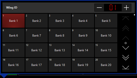

By default, the playback fader ribbon along the bottom of ONYX will be “Wing ID” 00. Therefore, if you would like this playback fader ribbon to stay synchronised with your NX Touch, you can set the Wing ID so they match.
The NX Touch will likely have defaulted to Wing ID 01. Therefore, you could change the playback fader ribbon to Wing ID 01 too.
To do this, click the “Bank” button bottom-left of ONYX. From the popup, set the Wing ID to 01…
I hope this helps.
hi
yeah that worked
thank you
