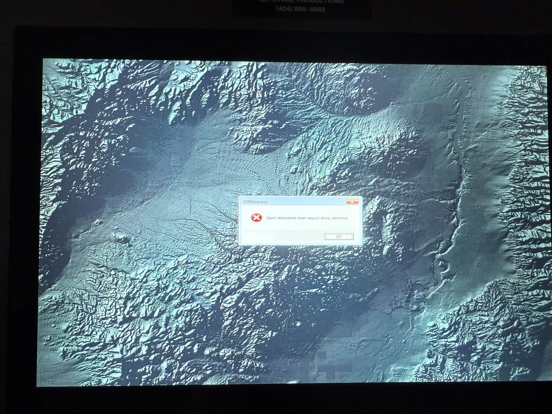

I’ve already updated the BIOS. When inserting the drive with 4.10.1271 ISO on it, system recognizes drive and prompts to boot from drive - I confirm. Gives warning window, I confirm. Then errors with “Can’t determine boot source drive, aborting”. Has anyone else had this issue or know why this is happening? I’ve tried with a few of the archived 4.10 ISOs here but all have the same issue.
Displayed Error:

And still errors:
