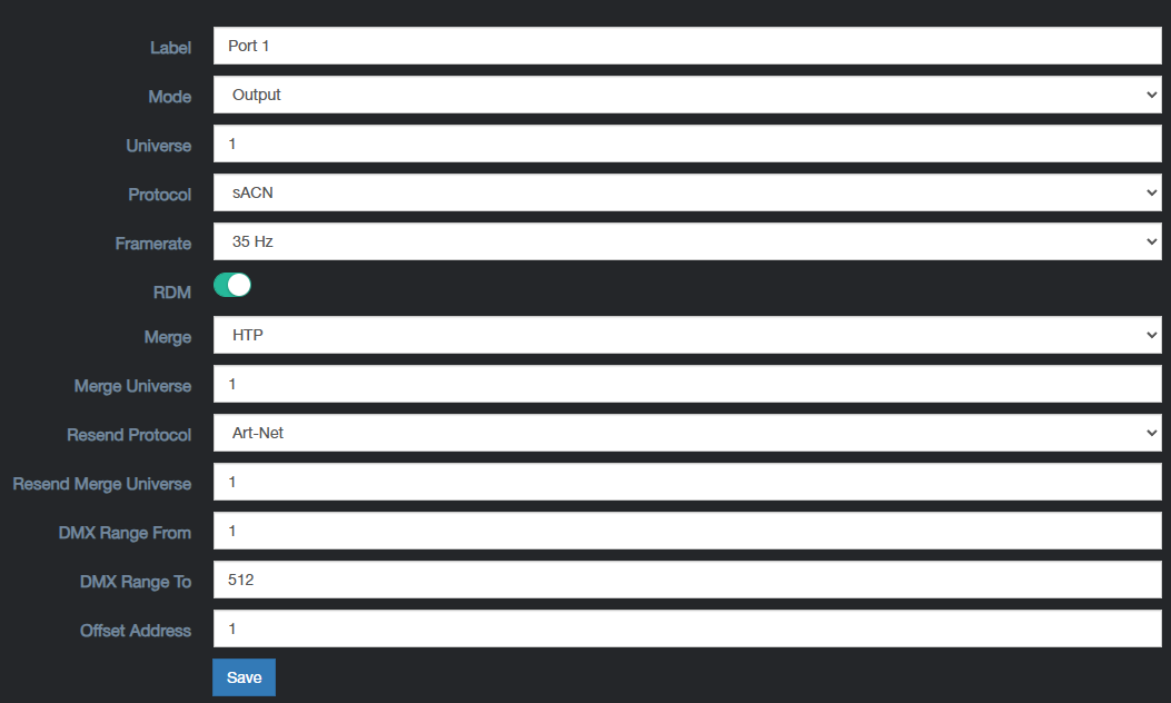

we try to resend a universe on a free en12 output. how can we do that?
at the first try it works anyhow, but at the next try it does not. how exactly can we do it?
we send 4 universes sacn from a nx1 to an en12 to port 1 to 4. we set port 8 to merge htp universe 1 and resent it as artnet to universe 8. is this correct? shoud this work for sending the data of universe 1 from nx1 to artnet universe 8 in unicast mode?

we found out, that the en12 only resend the merged universe via artnet if it is set to dhcp. if we choose a costum ip it does not do it!? why is this the case?

Hi @deflost
To configure this, configure a spare port to receive the sACN universe destined for Resolume. Then, enable an HTP Merge, and set the Merge universe to match. This will then allow you to configure the Resend Protocol to Art-Net, and set the Art-Net universe Resolume is expecting…
This port will then receive this sACN universe from both sources, and the source with the highest priority will then be converted to Art-Net.
I have tested this on both a Custom and DHCP IP address, and this functions as expected.
Please let me know if you have any questions.
