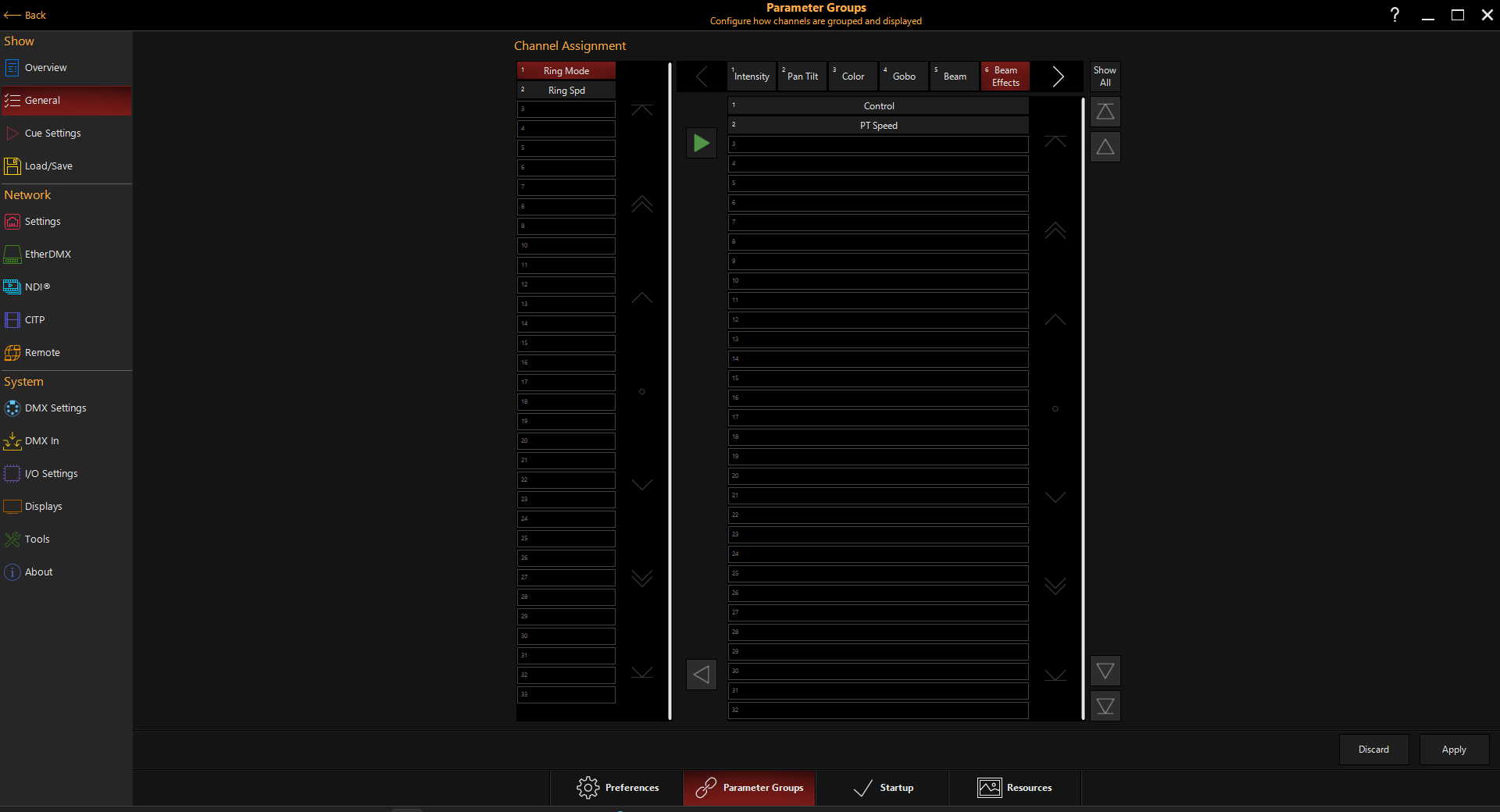

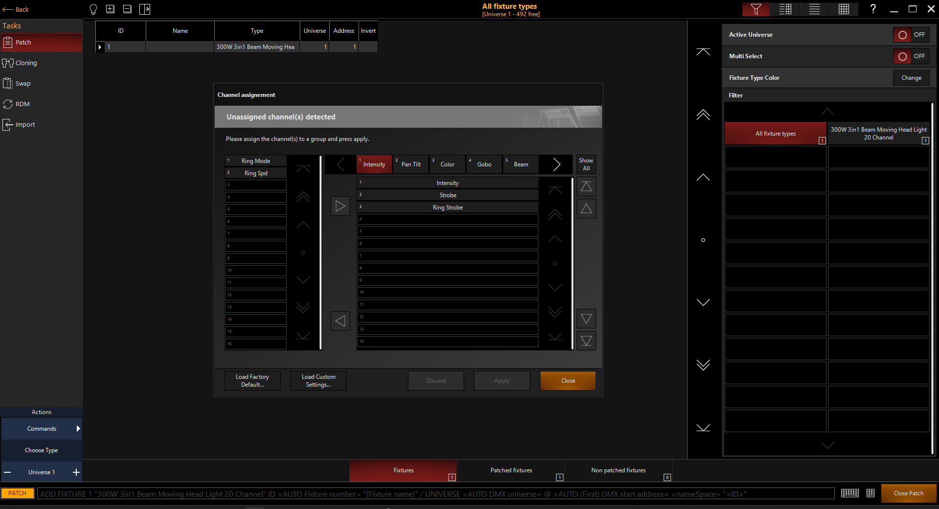

I cannot access ring mode and ring speed :anguished_face:
Ring strobe control can be found in the intensity section but ring mode and ring speed are nowhere.

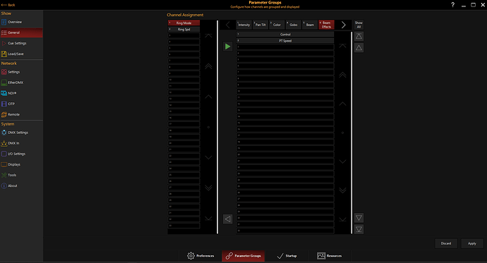

@nem357 -
The Ring Mode and Ring Speed, as a new fixture, are not automatically assigned to a parameter group. This will require a fixture profile adjustment on both the 20 and 23 Channel modes. I have submitted a fixture correction for this, but I don’t have any physical units. In the meantime, you can assign those yourself, so you can control the lights. Most time things like this end up in the “Beam FXs” parameter group.

That’s awesome!
Thanks for that tip, I’ll give it a try….
:blush:
Watson!
you da man!
Your suggestion worked great!
Thx a lot!!!

@nem357 -
Loading the “factory default parameters” will not affect / change any programming you have already done. It will simply put the channel / parameter into their default category. You can change them however you like.
For example, you may want to move the intensity parameter to the color parameter group. Just like you can assign the “unassigned channels”, you can move ones already assigned.
