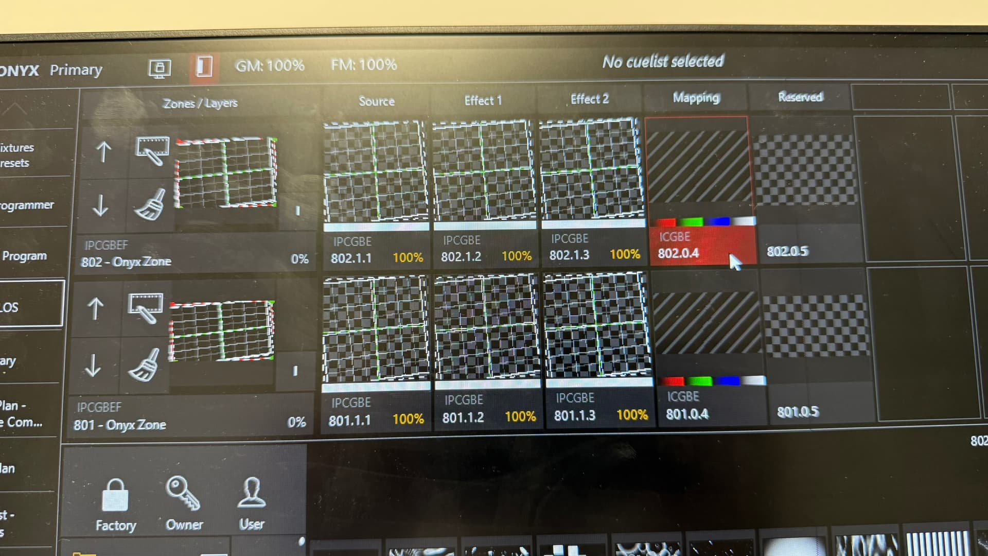

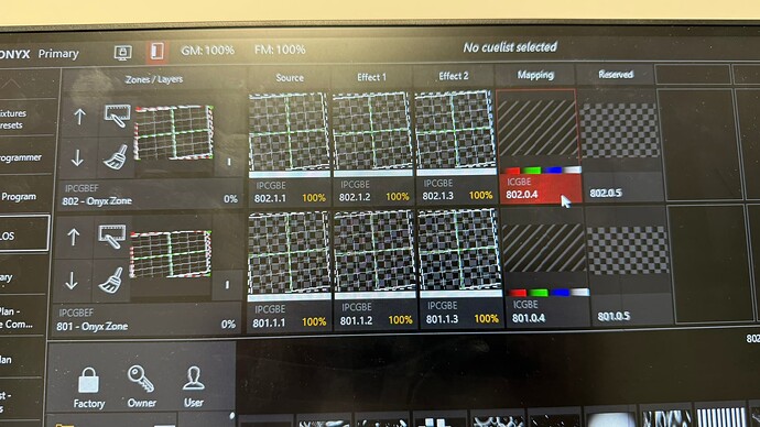

I’ve set up all my patch incl 2 Dylos Zones. When I wanted to test the Dylos mapping, I discovered that there’s some strange rotation pattern on both zones.
Not a single cue has been programmed, the programmer is empty, all channels are on default values. I can’t get the Dylos to play a video without this multiplied rotation that you can discover on the grid.
I’m using the latest release on an NX1.

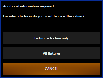

To reset a fixture’s/zone’s default values, go to the Output Center window, and go to the Defaults tab. Enable “Edit” mode, and then select the fixtures/zones you would like to reset. Then click Clear, and choose “Fixture Selection Only”…
You can then exit Edit mode.
I hope this helps.
