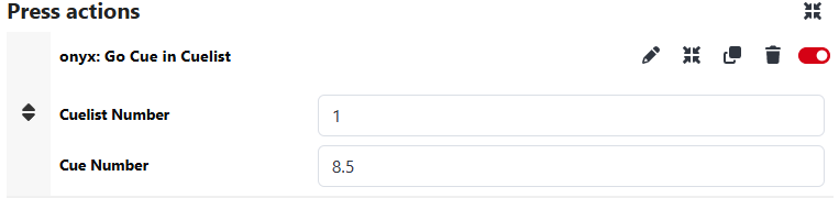

Please could you send me a screenshot of your Companion button configuration, or your Windows Telnet client?

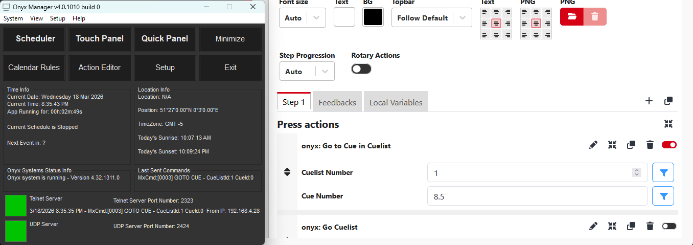

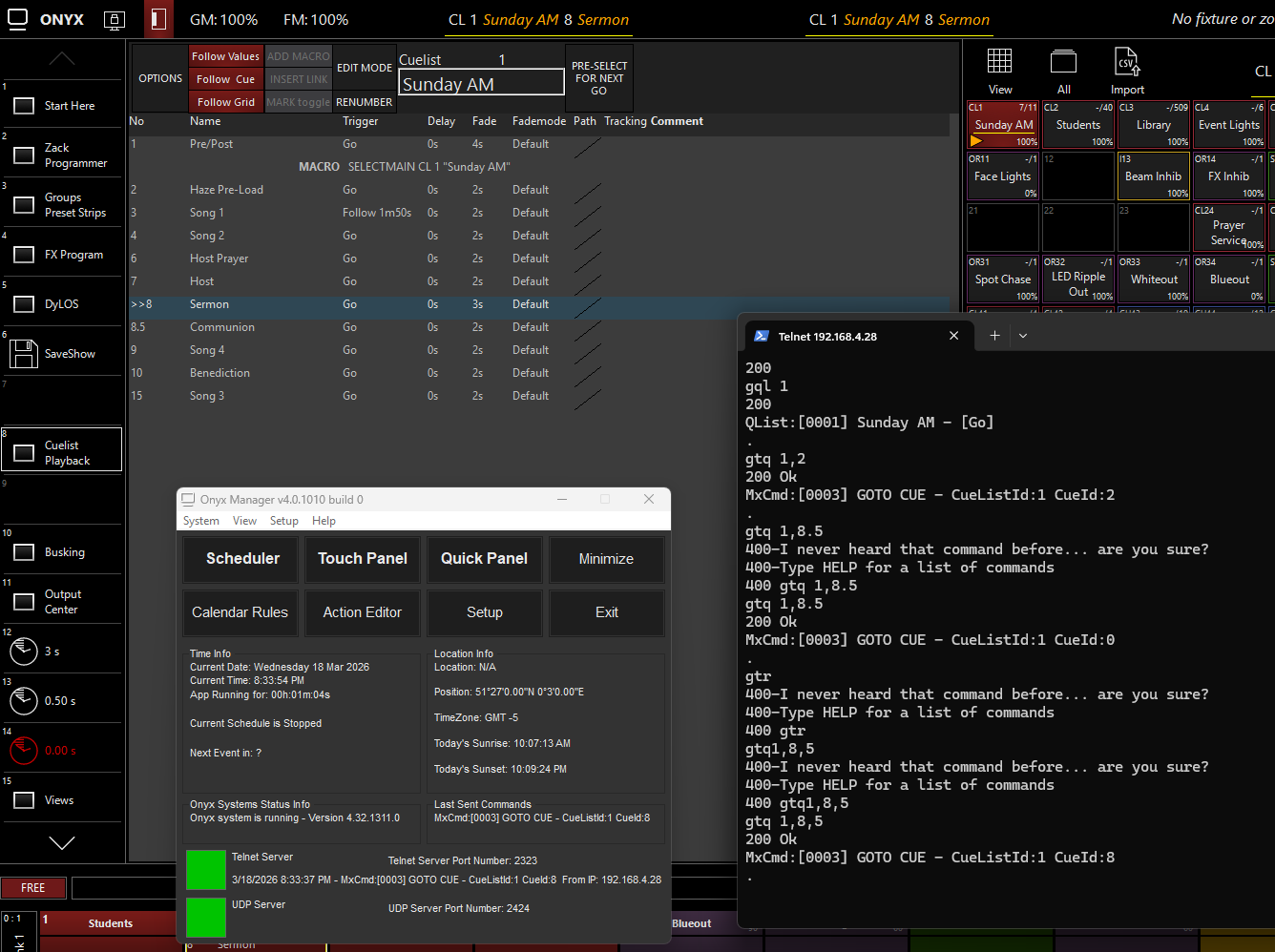

Thanks for your fast response.
I just updated to the latest release of Onyx (was running 4.32.08xx before) so now testing with Onyx 4.32.1311, Companion 4.2.5, Onyx Telnet module 1.0.5, on an up-to-date Windows 11 box. Same problem persists. Have also tried this on my home computer (same OS and similar specs) and an instance of Companion running on a Mac (M1 Ultra Studio) running on the same LAN as Onyx.
I fat-fingered the command a few times, hence the 400s. Note that it can’t pull the cue ID when a decimal was passed to it (Onyx Manager notes it as CueId: 0), but using a comma instead of a period makes it think there’s an additional argument and it goes to cue 8 (“Sermon” in the screenshot) instead.
I also noticed in your response that you also get a 200 Ok response, but I get that too for incorrect commands like GTQ 1. Can you confirm that Onyx is responding correctly or are you just getting the 200 Ok response?

Thank you very much for the screenshots. It looks like you are sending Telnet commands to ONYX Manager, rather than ONYX. Please close ONYX Manager, and instead send the Telnet commands directly to ONYX. You should find you can then trigger point cues.
Telnet can be configured in ONYX from Menu > Remote > Telnet.
