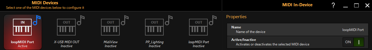

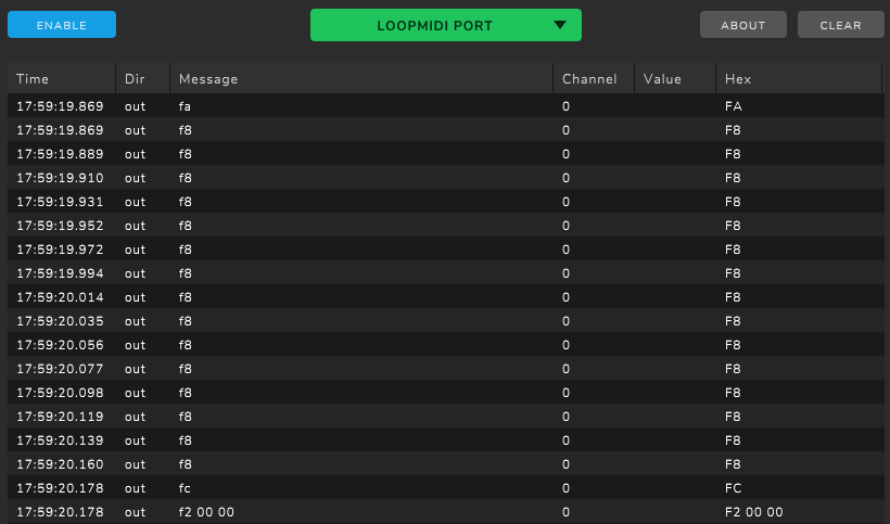

I’m trying to get time code working with Reaper, which we are using for backing tracks. I have LoopMIDI installed, since Reaper and Onyx are on the same machine. Reaper is outputting data, as is showing up in MidiView (Channel 0) as:
LoopMidi is Active in Onyx MIDI Devices:

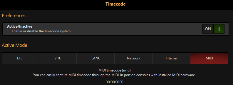

Timecode is configured to use MIDI and is ON:
I don’t see the timecode changing in Onyx.
