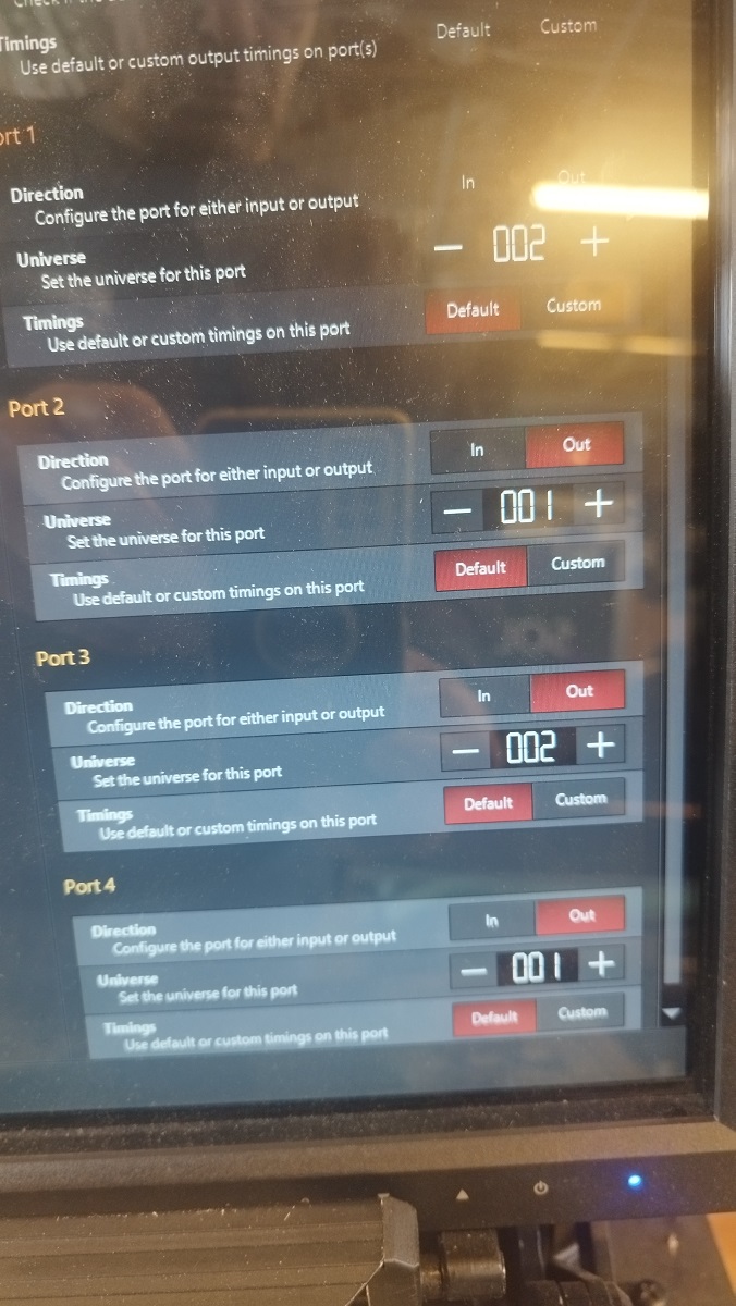

Hi all, I saw a topic about this problem on some Onyx users Facebook page but there was no definitive answer/solution.
Lately my system always starts up with a ‘wrong’ universe to port configuration, see attached pic. I can re-configure it and it accepts the new configuration (1, 2, 3, 4) but whenever I re-start Onyx, it returns to the ‘wrong’ configuration, and I have to re-configure again.
Any advice will be appreciated.

Hi @n.webber
Welcome back to the forum.
This issue can occur when the NX Wing’s firmware is out of date. To check your NX Wing’s current firmware, please go to ONYX > Menu > Tools > Diagnostic > Firmware Update. You should see two DMX devices listed, which should be running firmware v4.14.
Please see the link below for information on firmware updates…
Updating Console Firmware
