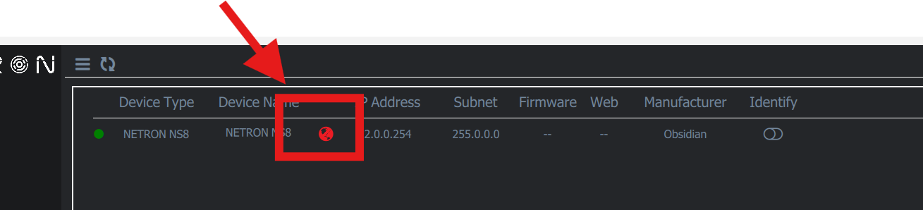

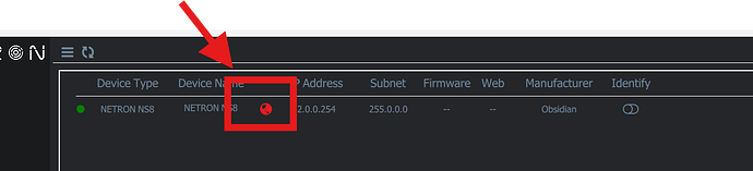

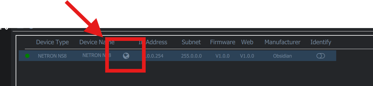

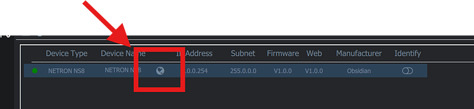

On main screen of CLU, do they show a Red or Grey little world next to the IP address?
If it is Red. then the EN4 are in a different IP range than the computer running CLU. They need to be in the same range for it to be able to update them.
It’s grey and the computer and EN4 are both in 192.168.5.0/24.
