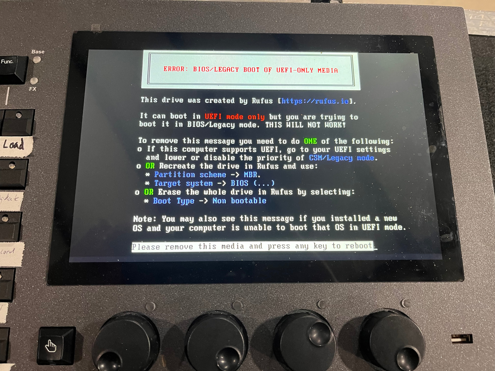

I was talking in the discord as well. I have been able to create the drive, but when putting it into the NX-1 it throws me this error screen. That is after trying multiple USB ports. Something seems very wrong
Hi @Mboitnott
Thank you for the photo. Normally in this situation, this is because the NX1 is having difficulty booting into the OS USB drive. Therefore, this can often be solved by formatting an alternative USB drive using the OS tool included with the ONYX OS download, and then attempting the installation again.
If an alternative USB drive is also resulting in the same error, it may be worth resetting the console’s BIOS. To do this, please email support@obsidiancontrol.com, and we can provide instructions.
