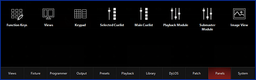

Would you be able to elaborate a little on your use-case for this? I’d like to understand what benefits a floating Playback Module would give on physical hardware.
hello, not floating, exact the same to fold out, so if you put on an additional monitor, you can get ten more fader on this display. isn"t it? thx.
Hi @deflost

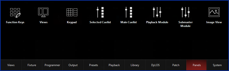

If you don’t need this as a floating window, you could go to Workspace > Launch Views > Panels > Playback Module, on any ONYX display…
Would that be suitable?
