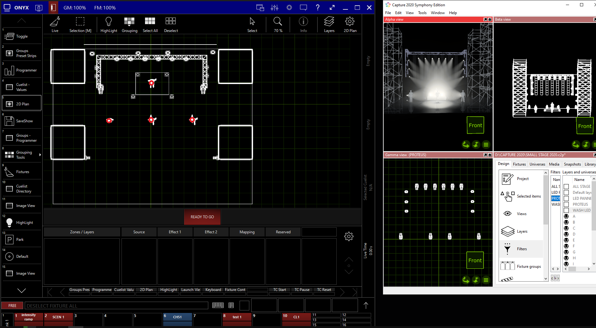

Hey gang. Loving the new citp link to capture. Just a few things that i have noticed. Sometimes i cant get the patch to import. It sees the citp link to capture just wont take the info and patch. A request. Is it possible to have the 2d view get sucked in from capture? Also work out which way around the fixtures need to be so that they match capture.
When you run into this problem again, have a look in Capture to check wether the project console link and the external universes are set correctly. If it still doesn’t work, you can send me a personal message on the forum and add your Capture file, so we can test and find a solution.
