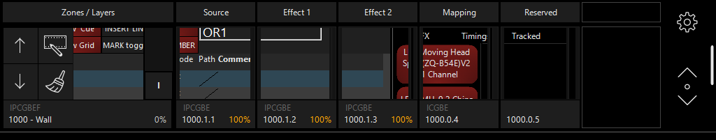

Every time when I switched views, the dylos preview would not update to dylos but instead stay in the last window’s content.
If the system was started on the dylos page, it displayed correctly until I switched views again, receiving the same issue.
I think it is important to mention that the preview was only broken on the zone composer. If I looked at my 2D plan and the single fixtures, I was receiving feedback from dylos. (I blindly followed content and generators to get something running)
