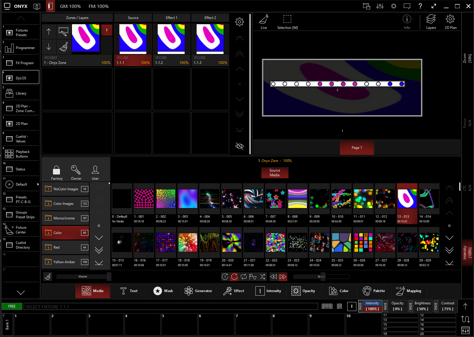

the generic 9 cell led bar works, we can not verify on stage, we have no real fixture like that.
also, when we put in a dylos zone in a new file with only one patched cameo pixbar, we can not choose content for the zone,
if we unpatch the fixture, also not.
but when we strt a new file without pixbar in patch we can choose content for the zone to play.
a new file with a generic 9cell bar works great.
we uploaded the files to the link.
please give us any information about the thing we do wrong, maybe you can have a look in our set, …

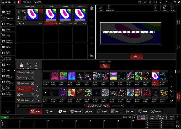

we also verified in capture, there are exactly the same behavior, than on real fixture, when we control the cameo with the generic 12 cell fixture from library.
and they will do withe cameo profile in 78ch mode nothing, till we adjust the master intensity, and then they do this:
and withe the wrong generic 12 cell profile they do this:
thx.
r.h.
My result is like this:
we see the same in dylos, but on real fixture the intensity (the bright part of the fixture around the pixels!!! in dylos view) is brighter then the color and if you move the content also the differents in intensity, can you look at capture, please. in the video with cameo profile u see the look.

we uploaded two videos from the dylos view, comparing to the capture videos,
with the upload link, because of the size…
