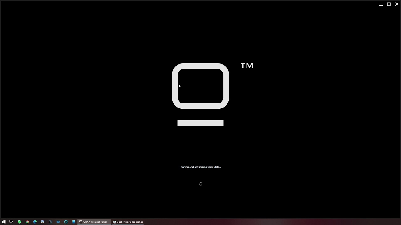

I’ve got an issue which make me lost my last 2h of works (patch, 2d plan).
I don’t know what really happen, but my show seems to be corrupted.
Before the issue:
I had patched 8 Robe Robin Tetra2 in RGBW Mode 4 with virtual dimmer off.
Once patched, go to 2D plan, Add 1 Tetra 2 as combined fixture, and, with the circular insertion (that’s an error of selection from me the circular), and go.
Onyx try to add it without success.
From there, I have the “PATCH” status in yellow display in the command bar, not sure if it was present before, didn’t really taking care.
But, from now on, the 2D doesn’t answer at all.
So i’ve decided to close Onyx.
At the reopen, I’ve lost my patch and 2D plan. But, I’ve tried to patch again the Tetra 2 fixture to see if I can reproduce the bug, and I can see that the patch start after the ID and after the last inserted fixture.
So, there something that happend in Onyx, and the show seems to be corrupted somewhere.
