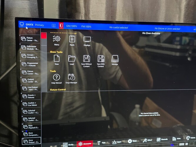

The source is on my desktop and my desktop cannot see my laptop or desktop source or VST. The desktop is brand new it was bought last week. I had the same problem on my old desktop as well. It has to do with Windows 11 24H2 and Onyx. I can send you a video if you would like. It’s not the settings as I’ve stated NDI tools works fine in the laptop and Desktop. The NDI setting in Onyx is enabled. Here’s some screen shots:
I can confirm it’s not a network problem as my NX1 is on the same network as the laptop and Desktop and it can see the NDI nodes as well as the VST plug in and it can use it. I tested the WAV form on the NX1 and the stuttering of the waveform seems to be fixed so that’s good. It just broke everything else…
does anyone else test the citp patch import from capture? it does not work for us. thx
I figured out that Onyx doesn’t allow two NICS at the same time which is odd because I’d like to isolate my ARTNET to a NIC and NDI/X-Net to a nic. If I disabled my Artnet NIC and then disable my X-Net nic and then re enable my X-NET NDI works and the local node shows as well as any test patterns and video feeds. As soon as I re enable my Artnet NIC the NDI node goes offline. I have the Artnet nic set as refereed NIC in NDI tools. The Artnet is on its own universe in the 2.xx.x with a subnet of 255.0.0.0 and the xnet NIC is on 192.168.0.10 with a subnet of 255.255.255.0 and is fed to a managed switch which is connected to a wireless router with no internet.
