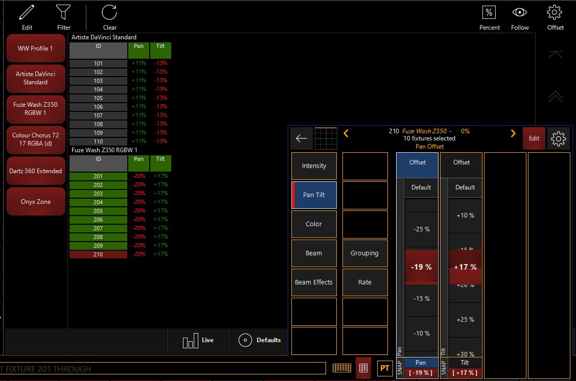

My experience so far: I loaded an existing 4.8.1240 showfile, it took a few minutes to load but came up fully functional. I added th offset programmer view and tested changing the offset on some of my spots. It took me a minute or two to fifure out how to go into the view settings and enable editing. I think this would be easier if it was a button on the view tool bar instead, similar to editing the 2d plan. I saved the show file with the new view.
Not sure I understand, that’s how it looks and works?
